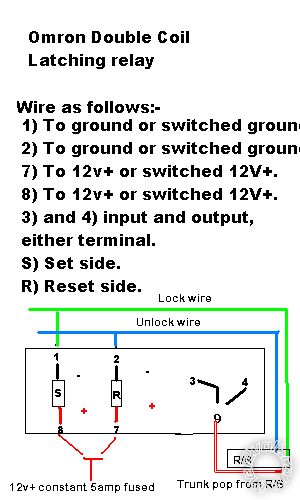

And even then you could use your lock/unlock outputs to control a latching relay which will give you window control when locked and trunk release when unlocked via the trunk release.
Or stick with the 529t when you only need the GWA wire.
Posted: April 09, 2012 at 6:03 PM / IP Logged
Latching relay diagram part number in title, Mouser Farnel etc.

the pop trunk wire from the remote start is connected to the input of the bypass. and im thinking of purchasing a 12volt wireless remote control switch. could that work??
