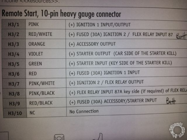

This is the Viper 10 pin starter harness:
2009 infiniti fx35 -- posted image.
Posted: April 20, 2012 at 3:40 AM / IP Logged
Only cut starter 1, violet to key side and green to starter.
Program the pink/white as second starter.
Power up all three of red, RED / black and RED / white.
Now look at H2 and with 2 relays and 4 x 1N4004 diodes:-

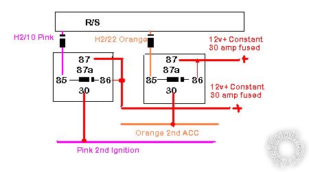

Ok correct me if I'm wrong on the 2 relays which are both the same.Should look like this:2009 infiniti fx35 -- posted image.
Posted: April 21, 2012 at 1:55 PM / IP Logged
First I made an error, it's GREEN to key side and VIOLET to starter side.2009 infiniti fx35 -- posted image.
The right hand temp diode is correct just cut the orange and pink and mount the diode in line. Your band position on both is correct.

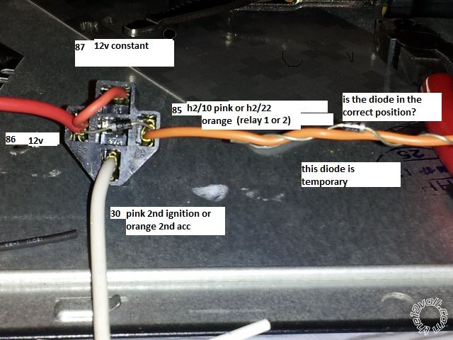

I did a test on the relays and something seems to be wrong,I am getting constant 12 volts on 85 and it will make the alarm non functional.
