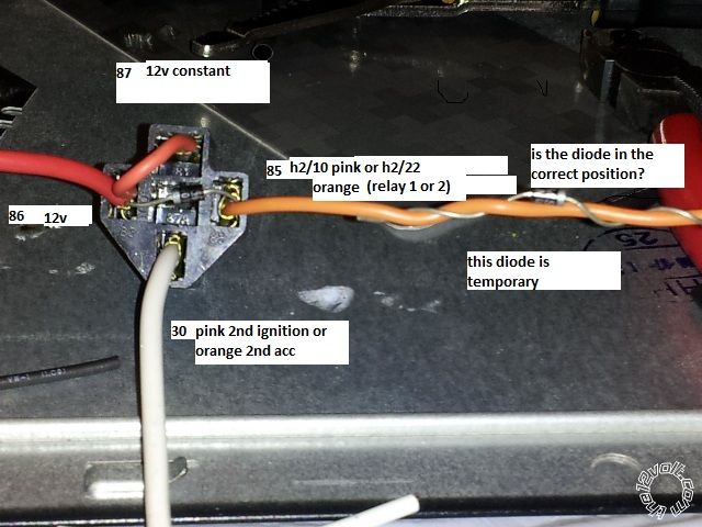

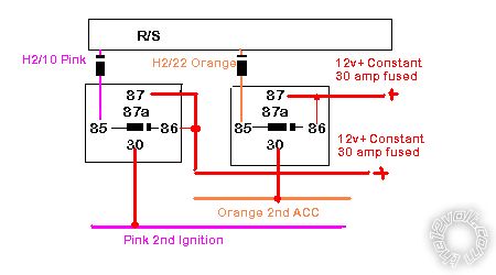

The right hand temp diode is correct just cut the orange and pink and mount the diode in line. Your band position on both is correct.
