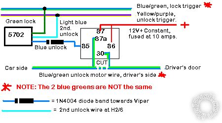

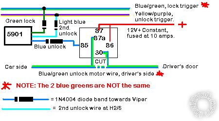

As for the priority (2nd or two stage unlock), look at this diagram, you will need a standard 5 pin Bosch/Tycho auto relay and a 1N4004 diode.
Do NOT attempt to do this without the diode. Without the diode you will fry the R/S brain.
Here's the diagram:- 2nd_unlock_with_low_outputs.bmp
Posted: May 13, 2012 at 11:12 AM / IP Logged
I just realised that with the older 5901 you will need 3 diodes, later instructions mention this, I've revised the diagram, look at it now:- Z25_2nd_unlock_with_low_outputs.bmp

great thanks a lot!!!!!!!!!!!!!!!!!!!!!!!!!!!!!!!!!!! that´s a very good diagram!!!!!!!!!!
