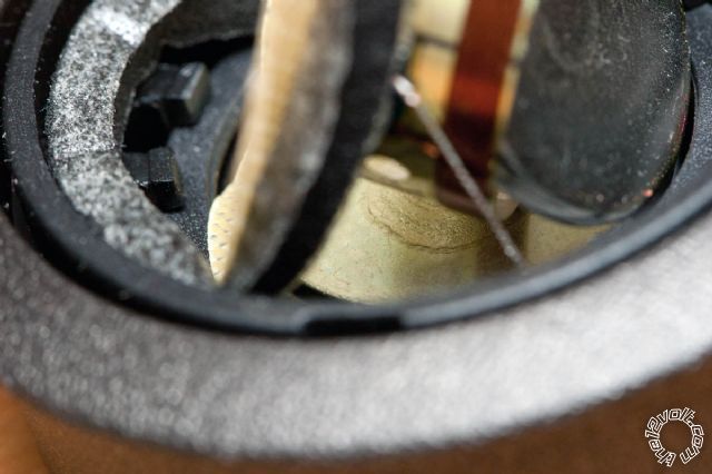

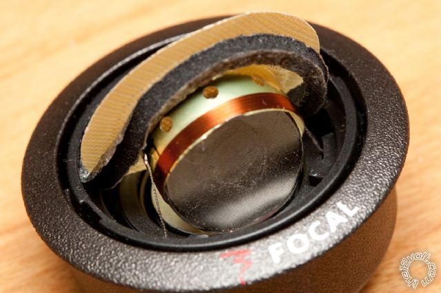

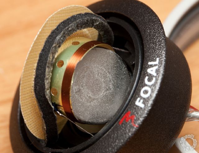

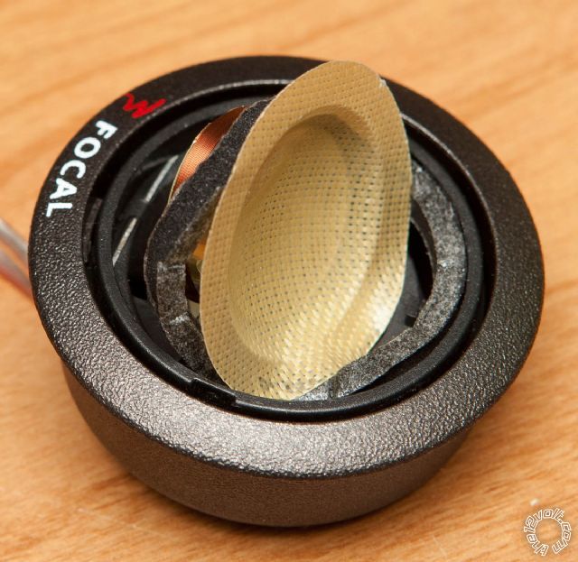

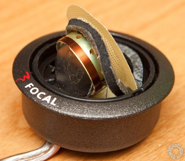

Here are the promised pictures.

If these had been purchased from an authorized dealer you'd have warranty coverage.  I do find it difficult to believe the tweeter just fell apart like that from being in the sun.  Looks more like someone put a thumb through it.

No thumbs were put through, I can assure you on that. It was covered by the included grill too. When I noticed what happened, first I thought the grill just popped out, but after a closer look I saw that the tweeter simply took a crap. I assume it's the sun, but who knows. Maybe just gave out due to a weak glue bond.
