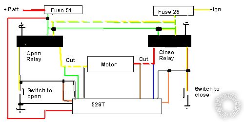

I will post a diagram for the sunroof assuming that model has two control relays, this method worked on the previous model Civic:-

You will also need a 529t for the roof or use my roof close method and two relays. You will have to wire into all 4 doors to get at the motor wires for the 530t's to operate correctly, a right PITA on Hondas.
