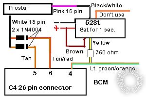

Posted: July 21, 2012 at 9:47 PM / IP Logged
Funny the photo shows the pink as GWR which is what you connect the by-pass to.
Posted: July 21, 2012 at 9:51 PM / IP Logged
My apologies we're BOTH right they just explain it badly.
Aux output isn't a by-pass a buy-pass lead by definition goes to ground when remote start is first activated, that should be the pink.

Posted: July 22, 2012 at 4:14 AM / IP Logged
1) What turns on the factory alarm, key in driver's door or factory remote fob? If so you don't need to worry about it, just don't turn it on.
2) When you say dome light are you talking about door triggers or dome supervision because that unit doesn't appear to have any!
I've given you a diagram for picking up the door triggers, also in that diagram, how to turn off the factory alarm, (see above) you need a DEI 528t timer module for this.
This is where you begin to realise that a cheapo without these facilities starts to cost you more if it even works. DEI, Compustar, Audiovox all have these facilities built in.
By the way, the dome trigger is NEG (-) not POS (+) as you posted.
