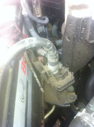

THX for the info soundnsecurity.... its a crime to see the cheap doodie wire Nissan used on the ground. I know a 4awg will fit thru it, but after i remove the factory wire i will have a better idea. Looking at the factory wire it just seam to go thru the sensor and not connecting it in any way?

Ground-sensor on 2007 Pathfinder
My thinking was to replace it with a min of good quality 4awg or better and soldiered terminals. Also remove the paint under the bolt where the ground sensor is bolted down with a smaller 10awg ground wire going to the somewhere under the fuse box ( cause Nissan did the smart thing by grounding on top of the paint ohio gen alternator for 2007 pathfinder -- posted image. )
Where did you run the frame wire, to the engine ground or to the battery neg? Also did you have to run your amp ground from the neg battery term to the Amp?

i grounded it to the frame right below the battery, nothing special except that i sanded down to bare metal and then i re-coated it with undercoating after i made the connections. i did not have to run the amp straight to the battery, if you did that then it would make no sense to upgrade the factory battery ground. i just made a solid connection close to the seatbelt bolt on the drivers side.

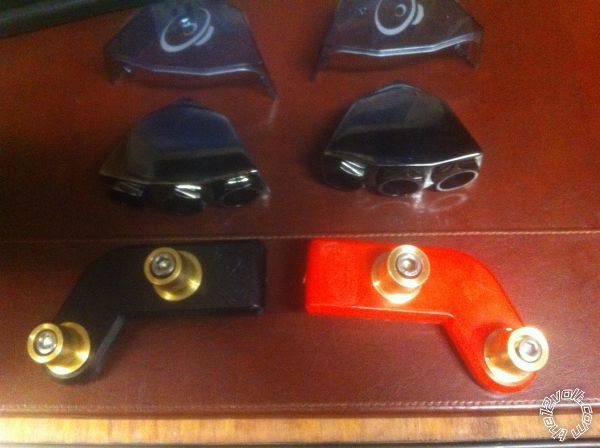

received my XS bus terminals and knukonceptz battery pos and neg mounts yesterday. This will allow me to add the room i need for the added wires and leave the factory connection in-tacked.

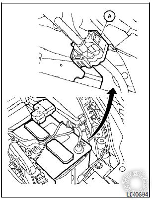

Okay here is what I have found out about Nissan's:
Variable voltage control system:
CAUTION:
- Do not ground accessories directly to the battery terminal. Doing so will bypass the variable voltage control system and the vehicle battery may not charge completely.
- Use electrical accessories with the engine running to avoid discharging the vehicle battery.
Your vehicle is equipped with a variable voltage control system. This system measures the amount of electrical discharge from the battery and controls voltage generated by the generator.
The current sensor (A) is located near the battery along the negative battery cable. If you add electrical accessories to your vehicle, be sure to ground them to a suitable body ground such as the frame or engine block area.
So the best thing to do is to swap the wire from the battery terminal to the engine ground and as soundnsecurity said use a heavy AWG to the engine ground to the chaise and ground everything to the frame.
Also stopped off at the Nissan dealer and spoke to a few mechanic's and they confirmed, that it doesn't matter the wire type and size, only that it need to pass thru the sensor and ground to the engine block.
One mechanic even told me that he upgraded his ground and it improved his idling & cold starts, had it for a year or so and no problem with the charging system to date.

That's good research and it makes sense.
I figure that they monitor current to determine when the battery is fully charged and drop the charging voltage from the normal max of 14.4V (probably 14.2V) down to a float voltage of about 13.4V. The fully-charged acceptance current - aka float current - is up to 2A for a large 12V battery.
[ Before my sideways clarity I was curious if it was another "ECU controlled" alternator which AFAIK is only for improved acceleration but at the expense of fuel economy (in most circumstances). ]
Normal vehicle charging systems use mere voltage regulation and have no need top monitor current - ie, alternators sense the voltage and adjust rotor current to maintain it at (say) 14.2V.
It'll be interesting to see if Nissan (and others) continue with this system. It is probably to improve battery life. In theory a 12V lead-acid battery should normally be charged at 13.8V and then drop to its float voltage of ~13.4V once fully charged. In practice, in vehicles charging voltages are now typically 14.2V or a max of 14.4V (steady-state) as the older 13.8V was too low to reverse sulfation that occurs in discharged batteries - hence leading to premature failure - and few bother with float voltages. Temperature compensation is usually the only sophistication that vehicular charging systems have.
The current sensor appears to be a loop sensor as opposed to a shunt (series resistor). Hence it should not be bothered by higher currents to & from the battery (even if the cable size could be and is increased), not that changing the alternator makes much difference to what current the battery accepts, or supplies.
If the battery -ve goes direct to the engine and is left as is, cranking won't improve unless the +ve cable from the battery to the starter is improved. However improving the engine to chassis cable if the battery- goes to chassis will improve cranking.
But a heavier cable can probably be run thru the current sensor even if stripping and re-sheathing one end to thread thru, through the inner diameter of the sensor is probably plastic that can be partially removed, though I'd ensure it is still insulated from the cable, and weatherproofed.
Note too that if the higher output voltage is preferred (ie, to its 14.2V - 14.4V instead of its ~13.4V float voltage), running a load of 2A or more direct from the battery should do the trick. The current sensor will sense that "extra" load and think it's the battery's recharge current and - by never dropping to less than a few Amps - deduce that the battery is not yet fully charged and will maintain the higher voltage.
That of course assumes that the current sensing is to adjust the voltage (for/to float) as I described. If the sensing is for other reasons, let me know and I will reinvestigate.

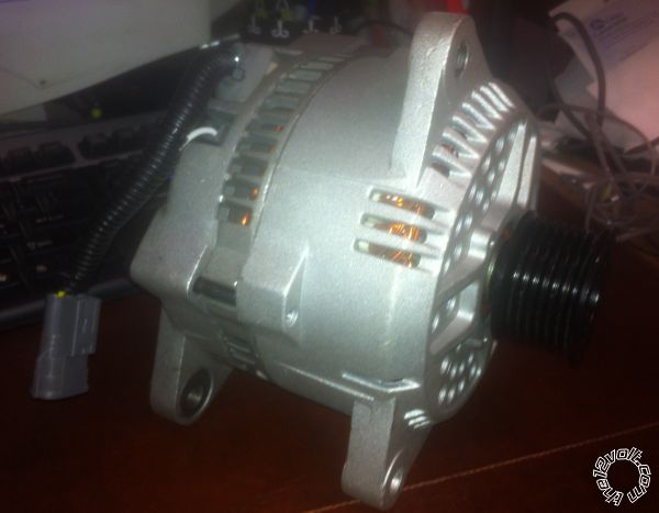

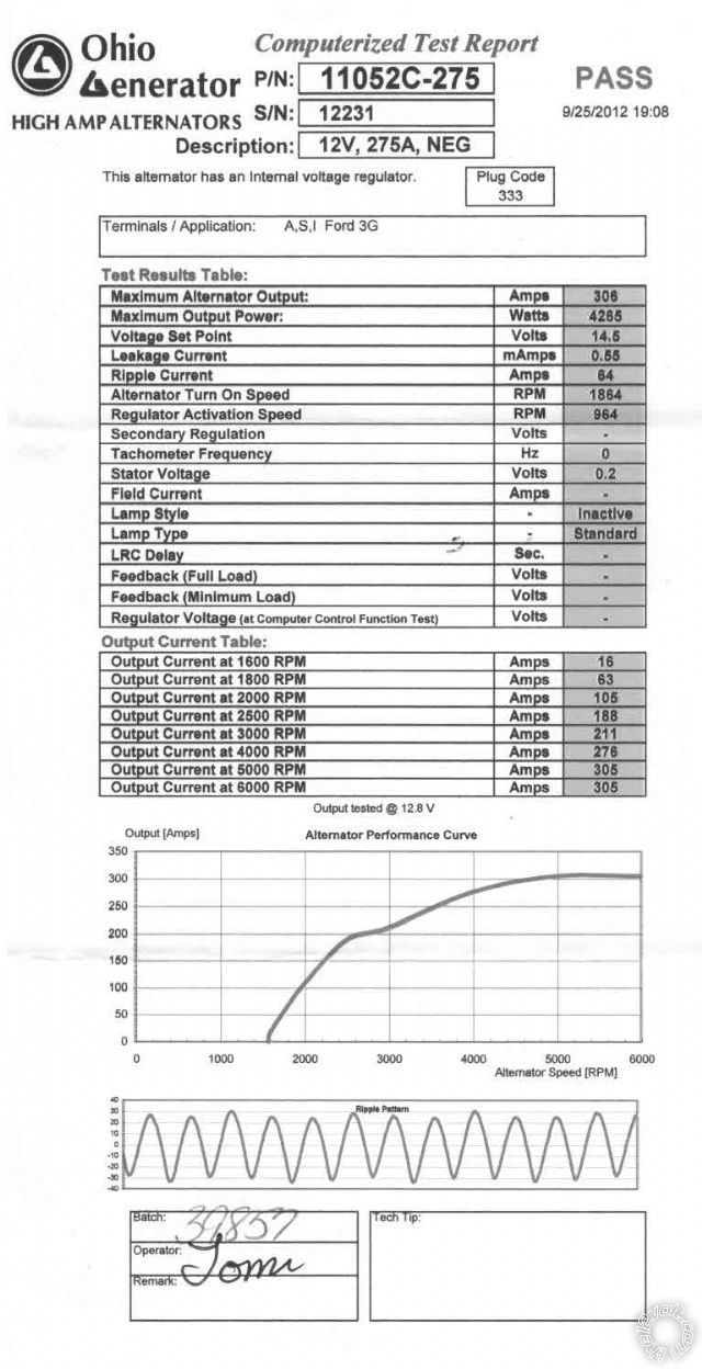

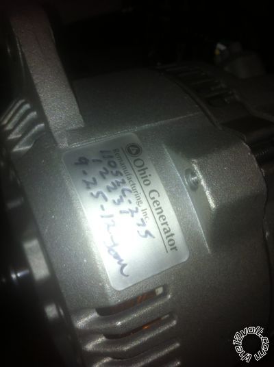

Just got the new Alternator in.
as a correction to my first statement it was 100AMP~125AMP @ 2000 RPM not 1000RPM.
any here are the spec and pic of the Alternator.
Spec Sheet
