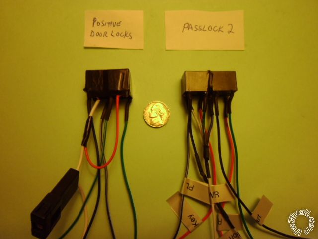

However, if the Equinox you are doing does not have the Factory Alarm, you could do this vehicle
the very old fashioned way, using relays and a resistor for the Passlock2 and relays to convert to
(+) door locks.  That would be a true learning experience, using a DMM to determine the Passlock2
resistor value and wiring up all those relays.  ( If you haven't done this previously. )
For low power relay applications, I use a mini 12V relay that is rated for 10 Amps.  Get them
online for less than 50 cents each.  The down side is there is no harness available, so each wire
must be wrapped & soldered to the relays' terminal legs.  Slightly cheaper than a DEI 451M ( $7 ).
2005 equinox bypass and? -- posted image.
Using your Viper, the Fortin Passlock SL2 and a DEI 451M would be the next easiest, being as you
already have the bypass.  Not sure if the Viper can be programmed to output a GWR and IGN pulse
with a disarm ( if the Equinox has the Factory Alarm ) like Compustar and others can.  You could
even  do this with relays, too.

Hi, Howard!  Prepping those relays on slow days for various uses ( Passlock2, Passlock2 for
Colorado, positive doorlocks, one wire (-) door locks, etc ) is time consuming but pays off when
you have one all ready to go for a last minute job.  With that Equinox, I would be all set for
the low price of $3 ( including fuse and heat shrink ) plus the R/S unit.  I still use the DEI 451M
for 5 wire REV door lock systems.  They have a higher current rating and I can save the Resistor
Pack to use elsewhere.
