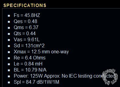

Click > DEH-80PRS for pioneers website for the 80PRS and look at the owners manual under "Manuals & Brochures" on the left side of the page. I believe the stereo EQ you are refering to is in the DEX-P99RS which is of course what i want...but not budget friendly. the 80PRS has a 16 band EQ and also Auto TA EQ with a mic just like my Premier DEH-980BT but it also has band pass crossover capability which i need to run everything active.
Below are the specs for the Anarchy's. Notice how their power handeling was not fully tested and therefore the 125W is probably very conservative and also note the low SPL/Sensitivity of 84.7db which increases my belief about them being able to take more power reliably.
So as to eliminate other doubts of their power handeling I had one in a box tuned to 40~50Hz in my trunk connected briged to my XA4200 amp which was giving it aproxamately 250w(I was being conservative with my 200w estimate below, XA4200 = 4x125w@4ohm) @8ohms of SUPER CLEAN power and it sounded like an 8" subwoofer and never bottomed out or had any distortion even at high levels.
