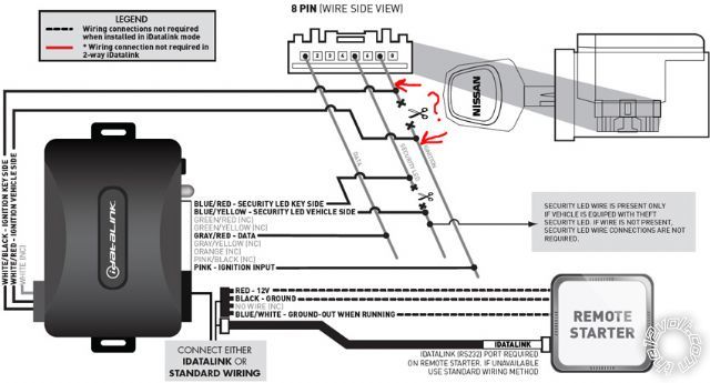

I'm installing remote start on a 2003 Nissan Pathfinder. I'll be using the idatalink ADS-TB unit to bypass the immobilizer..
According to the bypass diagram, I believe the 8pin harness shown is coming from the ignition switch (right?).
It will require me to cut the ignition wire from the vehicle and connect the ends to two wires from the bypass unit.
My main question, if this is the case which side of the cut ignition wire do I connect the ignition signal from the RS unit??? And does it make a difference?
Where to Connect Ignition from RS Unit? 2003 Nissan Pathfinder -- posted image.
Never worked with this car or bypass module so I'm a little confused on that bit, thanks in advance guys.

Yes and vehicle side.
And always solder the bypass connections!

Thanks for the quick reply.
I imagine during a normal engine start with the key the bypass unit will simply complete the connection on the ignition wire that was cut right?
I haven't seen the actual wires but I imagine the ignition wires on the car will be a heavy gauge wire, I'm wondering how the 22 gauge wire from the bypass unit will support the current?

The bypass will hook to the small guage wires to act as the key and key cylinder to the computer. The wires are small guage as the computer is turning relays on and off instead of a switch with heavy gauge wires running all the way to the switch. The bypass identifies wires by plug pin location and the remote start identification is wire color.

The idatalink diagram shows the wires and connections made at the transponder plug for the bypass. The remote start connections such as ignition, starter and accessory wires will be at a different plug at the ignition harness.

they are not telling you to connect these wires at the ignition harness, those wires are to be connected probably at the bcm or the imobilizer plug close to the ignition harness. pathfinders are not made with small gauge wires at the ignition harness. do not interrupt the main ignition wire with the small gauge wires from the bypass! no wires other than the main starter(starter kill) should be cut at the main ignition harness
the diagram they give you of that 8 pin plug is exactly what it should look like and should be the same shape. the plug for the ignition harness will be more square.

That makes way more sense. I hadn't actually started yet but was confused by the bypass diagram.
As stupid as the question may have been, I had to ask. Thanks for the help guys.

oh and this should help you out to know that you can probably find all of the main ignition wires in the drivers kick panel, the colors might be different but they will be the only heavy gauge wires in the kick panel so just test and verify. i know on my frontier that every wire was there except the 2nd starter, its still much easier than trying to connect at the ignition cylinder.
