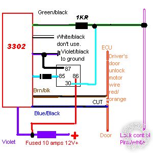

And here's the how to diagram including colour codes you will need a 4 or 5* pin relay Bosch/Tycho and a 1N4004 diode on the second unlock wire to 85 on the relay:- mazda_priority_unlock.bmp
* If 5 pin (more readily available), just ignore pin 87a.

what does the turquoise on the 85 relay hook to on the alarm i have all those colors but that one?

Posted: November 22, 2012 at 9:16 PM / IP Logged
I think it's supposed to be Ground, as I not to familiar with the 3203 units.

I only have
violet
blue/black,
brown /black,
violet/black,
GREEN/ black
white /black
but no blue on the lock harness on the alarm sorry if im misunderstanding just am not seeing a blue
Sorry corrected myself.
Standard relay wiring is 85 ground, 86 positive, 30&87a NC, 87 NO
Posted: November 23, 2012 at 2:33 AM / IP Logged
Actually it's supposed to be light blue second lock output.
Posted: November 23, 2012 at 2:34 AM / IP Logged
And that second relay MAY not be needed.

I stand corrected howie. As I stated, never used the stand alone alarms with internal relays.
But as the OP stated he dosen't have a light blue 2nd unlock so he can't have a 3002 can he? Or are there two date code revisions for the 3002?
