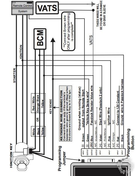

i have purchased the xpresskit pljx for the passlock bypass. but now looking at the wiring for that i've confused myself again... their diagram is a little strange
viper 5704 on 2003 cavalier -- posted image.
im not sure what the brown wire (ground when running status output from remote start) connects to on the 5704.
also im assuming to just ignore the vats part of the diagram
the last thing is the keysense wire. i dont think my car has that wire. only 3 wires are there (white, black and yellow). safe to just ignore this wire as well?
shortcircuit161
Silver - Posts: 556
Joined: August 29, 2010
Posted: December 04, 2012 at 10:45 AM / IP Logged
The brown (GWR) wire from the PLJX goes to the Dark Blue status output wire from the Viper. That's what tells the module that remote start is about to run.
You are correct, you wouldn't use the VATS section. That's a different and older type of antitheft system.
Keysense isn't necessary for this setup.
The white, black and yellow are the Passlock II wires that you will connect the PLJX to. Make sure the jumpers are set correctly before programming it.
