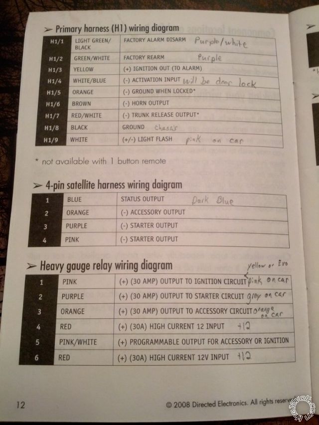

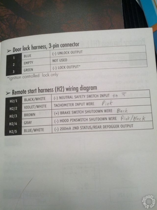

This shows what wires i have connected where on the viper.
2012 optima pts, viper responder one -- posted image.
Platinum - Posts: 7,828
Posted: December 09, 2012 at 6:57 PM / IP Logged
All looks good.  Can't think of anything else, unless you have the connections to the CAN wires reversed.
Does the Viper give any type of failed remote start Shutdown Diagnostic output ?
chaseacej
Member - Posts: 11
Joined: November 25, 2012
Posted: December 09, 2012 at 7:26 PM / IP Logged
Did the shutdown diagnostics and am getting the + brake shutdown code.
chaseacej
Member - Posts: 11
Posted: December 09, 2012 at 7:43 PM / IP Logged
i unhooked the brake wire and now the car will remote start. However, when I enter the vehicle and press the pts button twice to turn on the ignition it will turn amber for acc, then off. I cannot shut the car down with the pts button. I have to use the viper remote.
