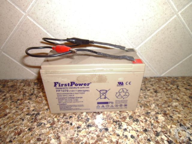

As for the back-up battery, the voltage is right but if the Viper has some sort of built in charging circuit,
it might present a problem.  Perhaps another Forum Member can jump in with some in-sight on this
aspect.  ( I use those same batteries during R/S bench prep to test and program the units.)    double checking relays -- posted image.
