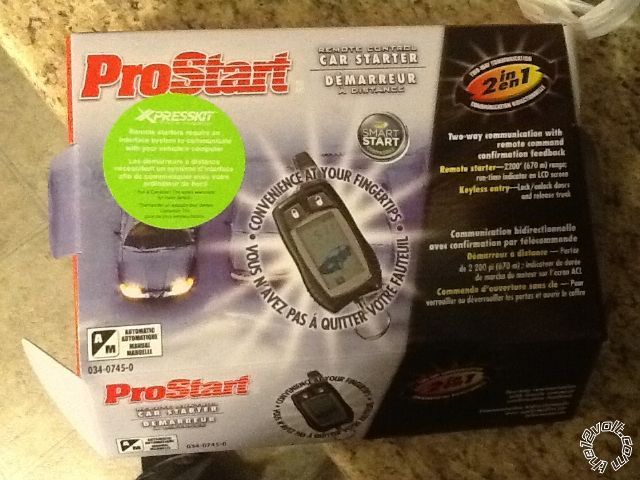

I have a pro start 2way starter. 1995 celica remote starter -- posted image.

You can find more info on the ProStart system at :  http://www.autostart.ca/prostart/prod-en_CT-3300.php
Can't help too much with the ProStart as it is not my usual brand.
Download all available wire guide listings and make up a cheat sheet using the ProStart's harnesses.  Post that for forum input.
