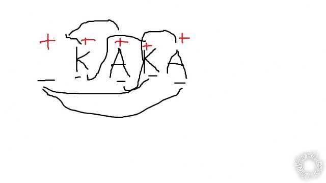

What does the frequency have to do with the ohms? Here is a picture of how I have it wired. It should be at 4 ohms. my amp is clipping, possibly tweeters? -- posted image.
littlenicky1
Copper - Posts: 54
Joined: June 17, 2012
Posted: April 18, 2013 at 8:28 PM / IP Logged
K is for kicker and a is for alipine and all speakers are 4 ohms.

If you are running the wrong impedance off a passive crossover, (and you are...) then you are DRASTICALLY affecting the actual crossover points! You'll have a doubling of crossover frequency in one direction, and a halving of the crossover frequency in the other direction. What I mean is this: if the crossover is 3500Hz at 4 ohms, then on the high-pass side, you're actually passing 1750Hz and up, and on the low-pass side, you're passing 7kHz and down! Your amplifier could be seeing well under 2-ohms between 1750Hz and 7kHz! Not to mention the EXTREME risk of popping your tweeters for the simple fact that you're crossing them WAY below their recommended crossover points!
Get those extra speakers off the output side of the crossovers, now, post-haste, and immediately! You are running in a very bad situation, and you'll have problems, and soon!
BTW... That PA amplifier will probably NEVER run 540WRMS per channel. If you're getting half that, I'd be surprised. What's the exact model number? NM... Just multiply the fuse value by 14.4, then multiply by 66%. Now, divide by 2. THAT is how much power that amp can make, realistically, and 2X that for PEAK output! Engine running. Less than that for engine off situations...
