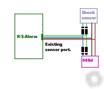

I installed a Autopage RS-665 r/s to my 02 Explorer. Everything works. Now I would like to install a proximity sensor. The alarm came with a shock sensor that plugs in to the brain.
To install the proximity, do I just tap into the RED / BLACK/ GREEN/ blue wires? Do I have to cut the green wire from the shock? Do I need to have another aux port? I would like the warn & full-out modes for both sensors.

Would this be replacing both sensors or is it just a re-named proximity?

Posted: April 22, 2013 at 2:58 PM / IP Logged
The 508d is compatible, a dual zone prox.
You will need 4 x 1N4004 diodes and the wiring is thus:-

Ok, thanks! that was fast proximity sensor -- posted image. proximity sensor -- posted image.
