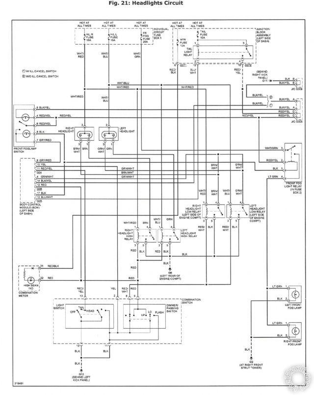

I would like to use both the wiper and headlight portion of the setup, but am having trouble figuring out the best method for wiring, particularly with the headlights. Based on the thinness of the wires coming from the headlight switch, I would think that the headlights are using a vehicle relay and that I can connect the raintracker's output directly to the wires coming from the switch without an additional relay. (Perhaps only diodes?)
I'm also not sure on where I should tap into the wires, should I do it close to the combination switches in the steering column where I can be sure of the correct wires, or should I unwrap the electrical tape of the bundle somewhere under the dash and tap into it that way? There's not a lot of room to work with either way.

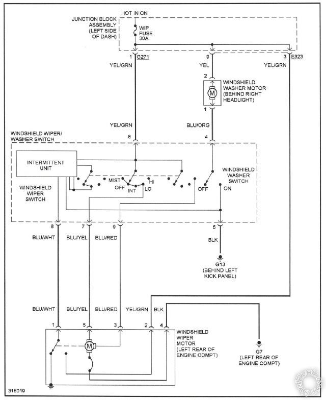

My first piece of advice is that if you do not have the ability to solder or make proper connections yourself I do not recommend attempting this as a DIY project. You may get into a bad situation where your wipers won't work while driving and that could be VERY dangerous. Aside from that I am a bit confused by the factory diagram. I do not see a high speed wire listed. This is where I would get out the DVOM and start testing at the switch. Again if you don't have these tools STOP and find a competent installer who does understand what you want.

From what I can see in the diagrams for your vehicle if you provide a positive voltage to the Blue / YELLOW wire you will power the Low Speed wipers and Blue/Red for High Speed wipers.
As for the Headlights, again this is what I take from the diagrams, Supplying a ground to the RED / White will power the low beams relay, ground on Red will power the Highbeams relay, and RED / Yellow recieving ground will power the Parking Lamps relay.

WIPERS - HSS Version:
Black -> Ground
Red, Yellow, Orange, Switches Red -> +12V
Grey -> Other side of switch from aboves red
White and Green -> Connect together only
Blue -> *cut* Motor side Slow wire
Purple -> *cut* Switch side Slow wire
Pink -> *no cut* Fast wire

Yellow -> Pin 86 on external relay (Polarity Reversal relay)
External Relay (Polarity Reversal Relay) Pinout
85 -> Ground
86 -> Yellow on raintracker (as stated above)
87 -> Park, Head lights-Lows (Diode isolate each) Test may have to do the Highbeams too, not sure
87a -> Terminate (or use a 4-pin relay)
30 -> Ground
Closing, TEST EVERYTHING FIRST, I only came up with this by looking at pictures of lines and swirls.

Racerjames - Thank you for the response. The high speed wire is the blue/red - the diagram duplicates the switch in order to fit everything - that's my take anyway. I am still considering a professional install, although I am dying to get my hands in there and do it! I would enjoy the experience, plus I like knowing the logic that went into such an install... oh well, maybe next time. It would be nice to find a place that would let me do it with them.

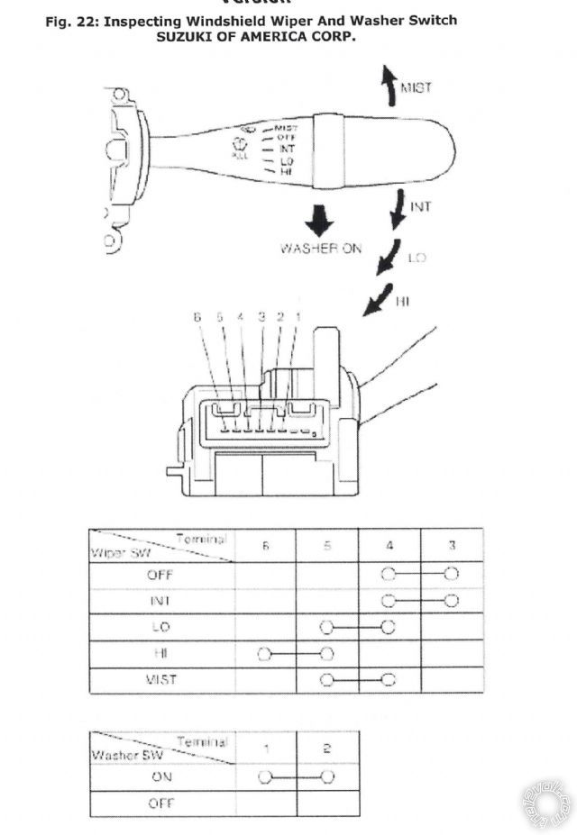

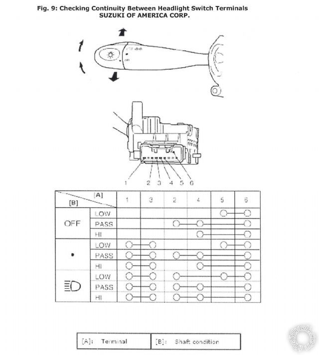

In case you were curious, I took note of the wires going into each combination switch:
Headlights
1 RED / yellow
2 Black
3 Black
4 Red
5 RED / White
6 RED / Blue
Wiper
1 Blue/Red
2 Black
3 Blue/White
4 Blue / YELLOW
5 YELLOW /GREEN
6 Blue/Red
