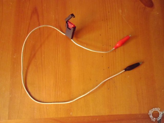

It may be unprofessional but I take a wire fused at 5 or 10 amps and touch it to one of the wires. If my fuse blows then I know I need relays. If the door locks work and the fuse didn't blow then I know it is just simple 12v. Just make sure your jumper wire's 12v source is rated at higher than the fuse you are testing with. Otherwise you will be trying to figure out which fuse in the truck you just blew.

Platinum - Posts: 7,827
Posted: July 13, 2013 at 10:13 AM / IP Logged
1996 chevy k1500 door locks -- posted image.    Hey, that's my quick test too! Fuse blows = Type C or Locks work = Type A
Saves cutting a wire or pulling a door panel, doesn't hurt anything (if you are on the right wire) and the jumpers' fuse is cheap.

Kreg I have the exact same setup except i even put an old program button inline to keep my fingers away from potential sparks. Low amperage it wouldn't spark much but I am a bit of a baby. LOL I feel we should clarify for future readers. This method is for a vehicle of a known wiring type and all considerations as to all possible outcomes are being protected against. We are not blindly jumping power to an unknown wire here. Test the wire for 12v before jumping anything to it. You would never use this type of method in a modern car unless again you KNOW every possible outcome and wiring type. /end disclaimer 1996 chevy k1500 door locks -- posted image.
