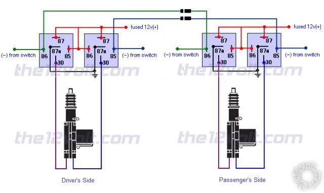

I would wire the actuators as shown in the following diagram and parallel the two switches. The switches do not need to be isolated.

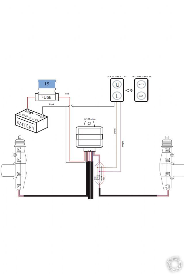

spall door locks with dual swithches -- posted image.
Thank you for your help ,

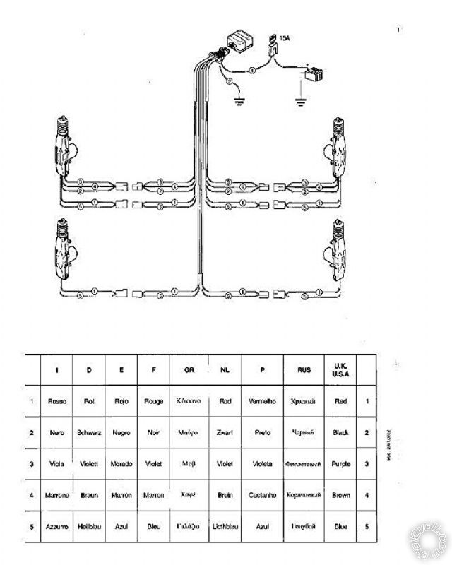

This system does not have relays it is just like the photo attached, the switches are attached inline to the brown & purple wires, in this harness, all of the wires respectively go to the same module. Ie . All browns are connected , all purples are connected. Does this mean i will need to wire install relays? Still confused.
Thanks spall door locks with dual swithches -- posted image.

the relays are in the control box/module at the top of the picture.
if the actuators you have have five wires, you should be able to disconnect the three position connectors at each and wire your switches in there. those three wires lead to a switch in the actuator to allow central locking by the front doors.

Still a little confused , as stated earlier each switch is wired in line of the three wire part of the harness. As it is by design the system is made to have only a master switch for the driver but i would like the passenger to be able to lock and unlock their side without it effecting the master on the drivers side while the master still being able to override the passengers.
     Note: in my situation there are only two actuators.
Can someone if possible draw it out? Still confused.

jr789, this will do what you described. Please pay attention to the direction of the diodes in this diagram (cathode sides toward driver's side switch outputs).
spall door locks with dual swithches -- posted image. the12volt • Support the12volt.com

Thanks 12volt. Does this change how the diodes need to be wired? spall door locks with dual swithches -- posted image.

In order to control the actuators as you described, you will need to wire everything as shown in my last diagram using four SPDT relays and two 1 amp diodes. The relay module that came with your kit will not be used. Only two wires from each actuator will be used.

You're welcome jr789. If you connect it all as shown in the last diagram you posted, it will be very easy to add a remote door lock system (keyless entry) by tapping into the brown and purple leads coming from the switch. Any reputable brand unit will work just fine.
