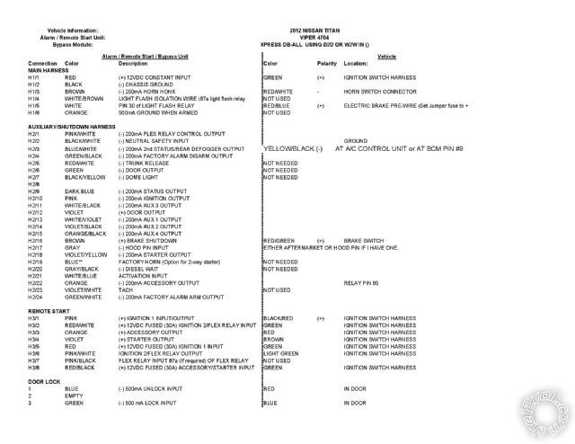

I've figured out most of the wires but want to confirm I'm correct and maybe get some answers on what I'm missing?
H1/1- Red - (+)12VDc Constant Input - Green
H1/3-Brown-Horn - RED / White (-)
H1/4-WHITE/ brown-Light Flash Isolation Wire - Pin 87a light flash Relay - ? Would this be Parking Lights RED / Blue (+) or on a relay
H1/5-White-Pin 30 of light flash relay - ?
H1/6- Orange- 500mA Ground When Armed Output - ?
H2 a little confused on:
H2/6-Green-(-)Door - red (Double pulse) in door
H2/7-BLACK / YELLOW-Dome Light Output-Blue (-)
H2/16-Brown-Brake Shutdown-RED / Green or RED / black (+)
H2/19-Blue-RED / white (-)
H3/1-Pink-(+)Ignition 1 Input/output - BLACK/ Red
H3/2-RED / White - +12V Fused Ignition/Flex Relay - Not needed
H3/3-Orange-(+)Accessory Output - Red
H3/4-Violet - Starter Output - Brown
H3/5-Red- +12V Fused Ignition 1 Output - BLACK/ red or not used?
H3/6-Pink/White-Ignition 2/Flex Relay Output - Not used?
H3/7-Pink/Black-Flex Relay Input 87a - not used?
H3/8-RED / Black-(+)12V Fused Accessory - Red

snutengine
Member - Posts: 21
Joined: March 10, 2006
Location: Maryland, United States
Posted: September 24, 2013 at 7:03 AM / IP Logged
viper 4704 on 2012 nissan titan -- posted image.
So, here would be the final wiring as I believe it to be. sorry I can't upload the XLS file. Not to 50 posts yet.
