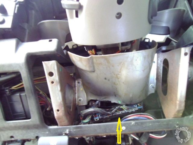

Just saw your post. Here is some help to verify the correct wire.
This is a photo of the lower steering column area with the correct
Brown plug in the BCM indicated :
2005 suburban remote start alarm -- posted image.

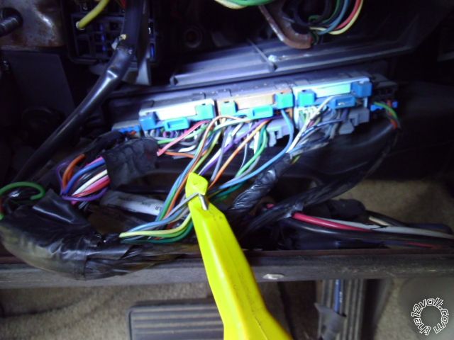

This is a close-up with the Gray/Black (-) Parking Light wire marked :

Posted: September 29, 2013 at 9:25 AM / IP Logged
Thanks Kreg, yep same location just the wrong color. I got it working last night. 2005 suburban remote start alarm -- posted image.
