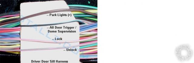

I usually try to make the R/S's connections in the drivers dash / kick panel area.  The BCM on that truck is on the drivers side rear cabin wall, I think.
Mercury switches aren't good for alarm installs due to the amount the hood has to be raised before it will trigger.  As you pointed out, using them for the hood pin on a remote start install in Pittsburgh or San Francisco wouldn't be a good idea, either.  I usually adjust them to trigger when the hood is about 2/3's open.  That will allow proper operation when parked on normal slopes.
Think if you do some searches on that model/series truck, you will find a picture of the door lock wires.  Still have to test, though.  Wait, I found it!
python 4206p r/s in 2006 f 150 -- posted image.

2     EMPTY      NOT USED      NA
3     GREEN      (-) 500mA LOCK OUTPUT        Pink / YELLOW     Type B      Drivers door boot/sill
1100F
4 Pin plug
Red to H1/1 Red
Black to H1/2 Black
9 Pin Plug
Pink to H3/1 Pink
GREEN/ RED - ECM-RX    to F150, Gray/Orange, Pin 4 @ 4 Pin transponder plug
GRAY/RED - ECM-TX       to F150, WHITE/ Light Green, Pin 3 @ 4 Pin transponder plug
This connection might not be necessary if the interior lights come on with a Factory RKE Unlock :
H2/7      BLACK / YELLOW      (-) 200mA DOME LIGHT OUTPUT BLACK/ Light Blue (+)     drivers kick panel, gray plug, pin 6
smokeman1
Platinum - Posts: 1,589
Joined: September 14, 2009
Posted: January 21, 2014 at 6:39 AM / IP Logged
H1/3 to Horn Wire Dark Blue(-) not the H2/19
H1/5 is the wire you want to use for parking lights.
H2/2 to chassis ground if truck is automatic
H2/7 Needs a relay to convert (-) to (+). Does your truck have keyless entry? Does the dome light come on when you press the unlock button? If yes, then H2/7 not needed.
H3/5 to 12 volts constant
