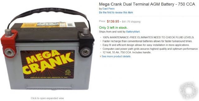

04nata
Copper - Posts: 358
Joined: April 22, 2008
Posted: February 20, 2014 at 7:59 PM / IP Logged
Found this DEKA, but it's AGM, great price though
battery -- posted image.
