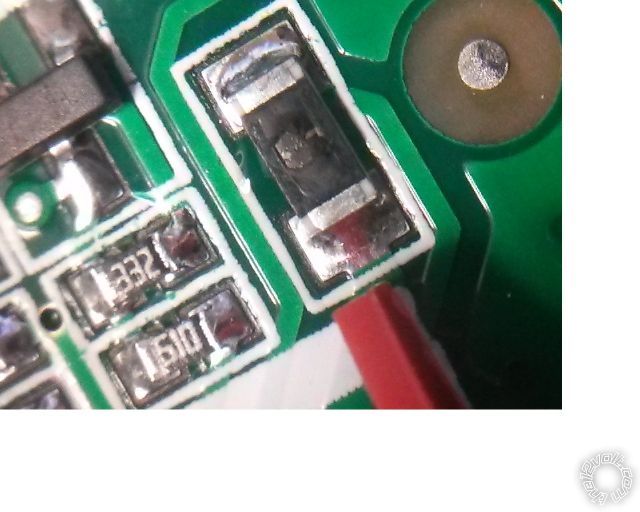

Sure in s**t. I lifted the warranty sticker by warming it up and gently getting under it with a razor. Got the board out and one of the micro resistors is completely obliterated. I can't even tell what numbers were on it!
Easily fixable, if I can find out what the resistor value was.
The resistor is right off pin 4 of the D2D port. Picture coming soon.

Posted: March 06, 2014 at 12:14 PM / IP Logged
d2d port dead -- posted image.

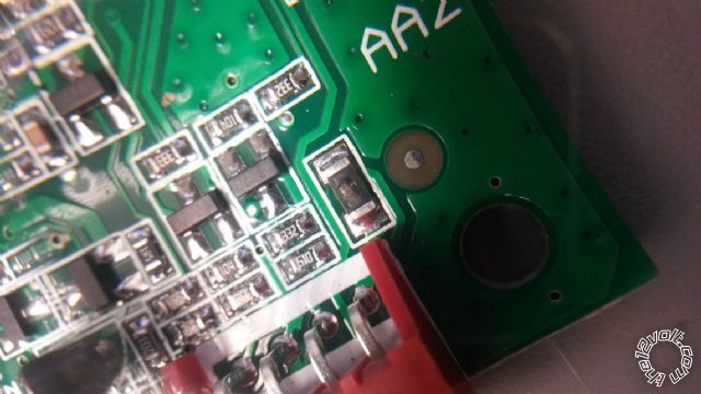

i have that brain laying around in the parts bin, i will open one tomorrow and snap a pic of the board.

Awesome sauce. Anyone willing to do a warranty claim for me? Lol, the warranty sticker is still fully intact.
I'm still curious what made it explode. The D2D harness is perfect - I was thinking a short, but there's no evidence.

the value of that piece has "100" written on it.
