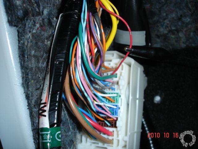

The EVO-ALL install shows most of the connections.  Here is a photo of the Ignition wires :
2008 nissan rogue remote start -- posted image.
