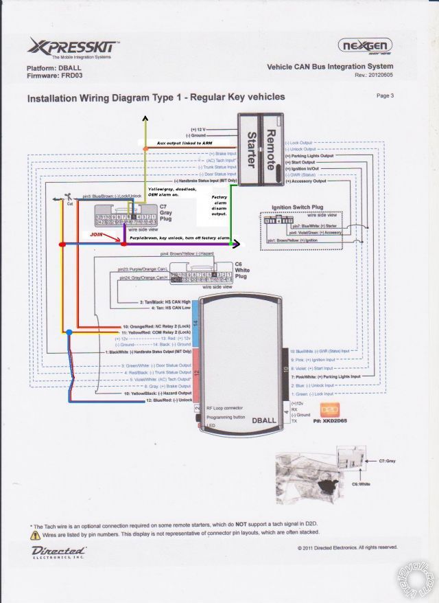

Some conflicting information on this car 2011 Ford Fiesta. Where is the best place to get the park lights and the locks. Some say single wire locks???? Any help would be great. Doing this car this week...Thanks

parking lights:
Front: GREEN/ orange,BROWN / yellow (+) @ bcm 24pin BLUE PLUG
Rear: PURPLE / green,WHITE/ orange (+) @ bcm 24pin GREY PLUG
OR
Negative headlight switch follow techdoc 1096
doorlocks bcm follow techdoc 1099
use the evo-all much easier

We used DB-ALL but hard wired the locks.
Use FRD03 software, follow BUT from the alarm, use an aux linked to arm or factory arm to yellow/grey pin 6 grey plug C7, factory disarm to PURPLE / brown pin 19, same plug.
This will give you ignition lock/unlock if required but will deadlock the vehicle on arming the alarm and turn off the factory alarm at the same time.
No need to go into the driver's door if this car use key ignition.

Try looking at the plug I mentioned above for the wiring before worrying about 1099.

If you mod this for the EVO-ALL it should work!

Howie asked me to upload this
2011 Ford Fiesta, Parking Lights and Locks -- posted image.
