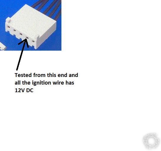

Posted: March 15, 2015 at 9:30 PM / IP Logged Link to Post Post Reply Quote cherxiong
I removed the connector from the box and tested the wires individually from the connection side and the ones that supposed to be ignition wires already have 12V.
For example:
2009 Corolla Japanese Made. - Page 11 -- posted image.

tedmond
Gold - Posts: 4,610
Joined: January 06, 2007
Location: Ontario, Canada
Posted: March 15, 2015 at 11:33 PM / IP Logged Link to Post Post Reply Quote tedmond

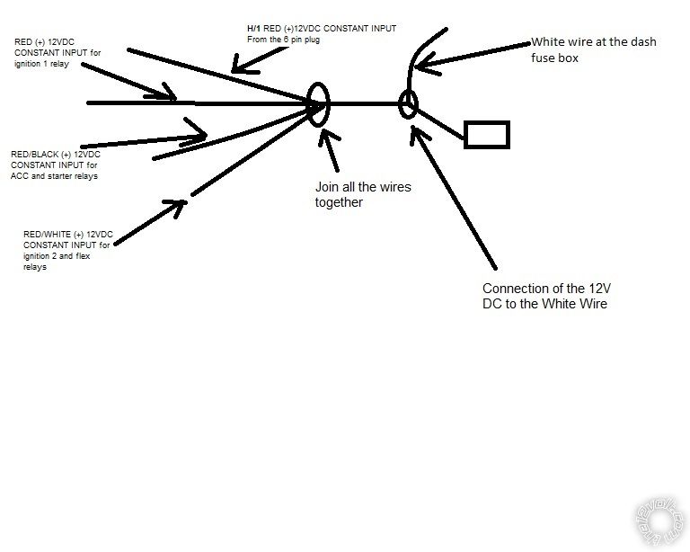

If you have 12v on the connector side, your wiring at the ignition is wrong.
Ted

Posted: March 16, 2015 at 5:58 AM / IP Logged Link to Post Post Reply Quote cherxiong
I combine all the 12V DC wire together before connecting to the white wire at the dash fuse box as below: Look to see and let me know if this connection create a problem.
