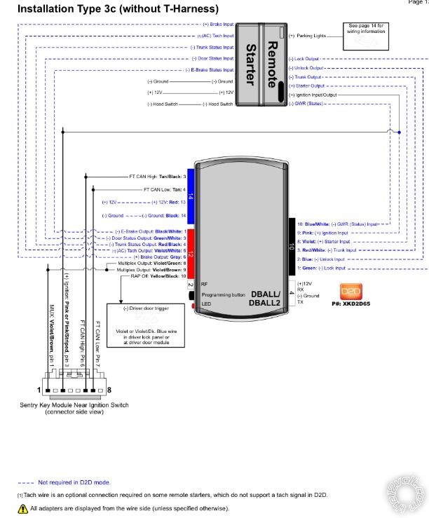

I bought and I dball2 5906v viper. and I need the wiring diagram for my car Jeep Compass Sport 2014 also if they can help me with the wiring diagram dball2 going towards the car. dball2 goes to "viper 5906v". please.
Posted: May 27, 2015 at 6:15 PM / IP Logged Link to Post Post Reply Quote howie ll
Go to Xpresskit.com Enter vehicle make and model will give you the wiring diagram for your vehicle.

I have not asked for anything for free only helps the wiring diagram, but someone wants to pay, I pay via paypall. Thank you. who help me with the wiring diagram (dball2 together viper5906v to my car I pay)
I know the forum, nobody forces, we are to help and not be selfish, this is to share, I thank all altruistic people, kindhearted help no matter who.
Posted: May 28, 2015 at 12:39 PM / IP Logged Link to Post Post Reply Quote howie ll
I've given you all the info the rest is up to you, N.B. don't use the adaptor leads, solder directly.
Also the DB-ALL2 must be flashed for that vehicle.

I know that. and I went to that site, and there are many wiring diagrams do not know, what it is for my car ?. my dball2 is already programmed. if someone wants to help me help me with the wiring diagram. I have been clear. WIRING DIAGRAM !!!!.
Posted: May 29, 2015 at 1:15 AM / IP Logged Link to Post Post Reply Quote howie ll
Diagram 3c with 9 electrical joints to be soldered including 12V+, ground and siren.

2014 Jeep Compass Sport wiring, dball2, 5906v -- posted image.
you tell me of it ?. remote start and where it says you should enter the viper5906v.
Posted: May 29, 2015 at 5:36 PM / IP Logged Link to Post Post Reply Quote howie ll
Try the part that says remote start.
Posted: May 29, 2015 at 5:41 PM / IP Logged Link to Post Post Reply Quote howie ll
How will you join the wires?
Do you have a DMM?

you mean the voltmeter. what I have, I installed stereos, alarms but have only had knowledge, and I have never seen as installed module as dball2
