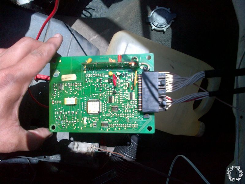

Good day.I would like to know if anyone on this site ever bypassed the immobiliser that came out with the microbus . I would like to know where the module is located.It use a dash touch-key immobiliser.

Posted: October 20, 2015 at 2:01 AM / IP Logged Link to Post Post Reply Quote howie ll
That means it's aftermarket, follow the wiring disconnect and make good.

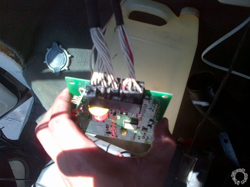

Posted: October 24, 2015 at 6:29 AM / IP Logged Link to Post Post Reply Quote chassis
Managed to get it cranked and the fuel pump running,can't get the engine management light to flash .It must flash rapidly before the bus can start.No info on the net,gonna try to get diagrams.

Posted: October 24, 2015 at 6:33 AM / IP Logged Link to Post Post Reply Quote howie ll
All wires, looks like they might have cut an engine ecu wire as well, too many wires for an immobiliser, I'm guessing it's an alarm.

Posted: October 24, 2015 at 6:49 AM / IP Logged Link to Post Post Reply Quote chassis
The small Pluck comes from the touchkey to give signal.the bigger pluck is where I got my fuel pump and starter from.would like to know how to get the ecu running without distroying it. The jetta III works exactly the same. This is not just a normal bypass,the circuit board doesnt even have relays.

Posted: October 24, 2015 at 6:52 AM / IP Logged Link to Post Post Reply Quote howie ll
Forget the board, trace the wires.
You can play with/bin the board when you're done.
