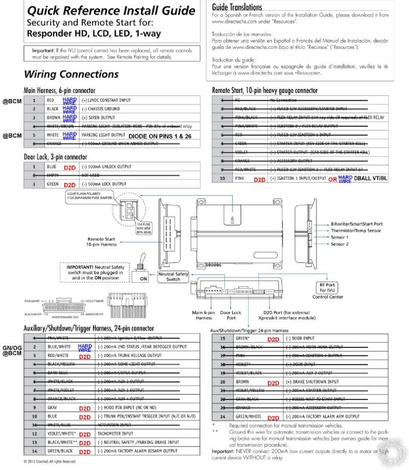

I received fantastic advice here so here are my new questions. I’ve attached pics of the wiring diagrams for the 5706v and Dball2, as well as the application charts for my car, ( for those that are learning like me.) I’ve marked on the 5706v install sheet which wires are “covered” by the D2D and don’t need to be physically wiRED / hooked up. I’ve marked which wires are D2D and which are Hard Wired.    I’ve also made some marks on the Dball2 sheet to reflect my Manual Trans application.   (I was able to flash my Dball2 with the correct FORD5 v1.13 for Push To Start)
1)     I’m using D2D, and the wiring diagram shows connecting an (+) Ignition status form the 5706v H3/10 PK to the Dball2 RED 12 pin connector/9. It says on the Dball2 application chart that it does “Ignition status” (last column in vehicle app guide pic). What’s the deal, hook it up W2W or not if using D2D?

1) Yes; violet/brown DB-ALL 2 to pink on H3 of the Viper.

I've now programmed the 5706v for a manual transmission in the feature menu. I've also performed the tach learn procedure, and received 2 parking light flashes in return, (D2D learned/response.) So now I'm getting the 7 blinks when trying to do a remote start. This means the MTS shutdown procedure has not been performed, so when I do that, I get another problem.
Doors closed, engine running:
1) Apply brake
2) Apply E/parking brake
3) Release brake
4) Push remote start button but I get an "Error" message on the remote.
My connections are all the same/listed above. Is there a way to verify what signals I am or am not getting via the D2D, such as verifying parking or foot brake apply is being monitored? I'm going to give my install and feature menu another once over, but I'm kinda' out of ideas. Any ideas/help is appreciated,

BLACK/ white parking brake input try hardwire.
Also temporarily set up as an auto, then try it, error code will point to what is wrong.

Ok, BL/WH park brake hard wired to vehicle harness (WH/VT) at BCM.
Remote Start MTS shutdown procedure now works correctly, however, it will not remote start. The car powers up, but I get a "push clutch to start" message on the dash display. It does this a couple times, then sets of the alarm.
If I manually depress the clutch during a "remote start," the car starts/runs fine.
Seems the Dball2 isn't generating/transmitting a clutch closed signal, etc or (?)

FIXED IT. I guess since I don't work on cars professionally anymore I also don't check my wires thoroughly...what a silly goose. I found my mistake double checking the clutch circuit via the factory electrical manual:
There are two BU/OG wires in connector C2280A at the BCM, one is from the clutch switch and the other is from the hood switch. I had my Dball2/Clutch / YELLOW wired to the hood switch, WRONG! So when I connected to the correct BU/OG clutch wire and did a remote start procedure, all worked perfectly.
