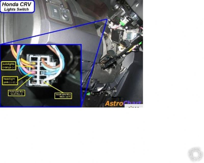

I'm currently installing a remote start in my 2010 Honda CRV LX. My instructions tell me to connect my 12-pin white wire to the (+) Parking Light Wire which should be red, and located above the interior fuse box. I found this thread where someone mentioned it should be in a blue plug but I don't have the plug. Another thread, here, says it should be in a blue plug in the driver kick panel but I don't have any blue plugs in there either.
My instructions, which are supposed to be specific to my vehicle, say it is a red wire by the fuse box. Any idea which red wire?

Its probably easier to access the negative parking light wire and its located at the headlight switch which is in a WHITE/ black plug @ the headlight switch and the wire color is blue. What kind of remote starter and bypass module are you using ? Maybe we can help you with the connections .

Use the CR-V's (-) Parking Light wire as Trini suggested.  Connect the RS1-G5's RED / Black wire to Chassis Ground
and then the White Parking Light wire is a (-) output.  Connect the White wire to the CR-V's (-) Parking Light wire which
is Blue at the headlight switch ( WHITE/ black 12 pin plug, pin 11 ).

As for DMM usage :
To look for a (+) wire, set the DMM to 20V DC, connect the Black test lead to Chassis Ground and the Red test lead to the
suspect wire.  You will see ~12V DC when the signal is present.
To look for a (-) signal wire, set the DMM to 20V DC, connect the Red test lead to +12V constant and the Black test lead to
the suspect wire.  You will see ~12V DC when the signal is present.
