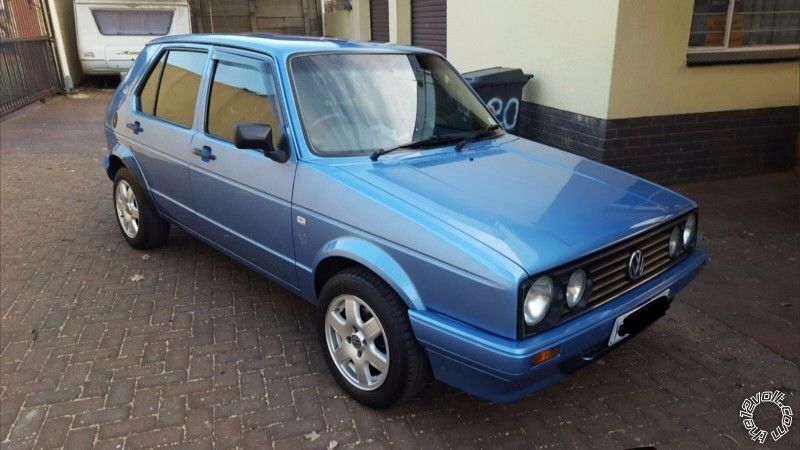

Good day. Can anyone assist me to stop the above vehicles hazards from flashing. I think it has to do with the vehicles theft system.Its not the hazards switches etc. It stops when removing the shurlock bcm from the harness. The bcm has been replaced with a new one already. Is there any resetting that needs to be done?VW golf 2005 flashing hazards -- posted image.

The internal relays on the alarm have shorted get rid of that alarm.
You'll need a Shurlok manual to answer your question.
