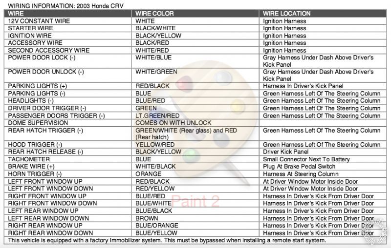

I'm seeing positive parking lights as being RED / yellow, there is a note however saying "Can also find a RED / Black in the connector above Kick Panel NOTE: " Dealer only to : ( to program another key "

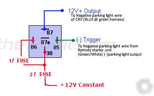

So if i connect the Negative parking light wire, do i need a relay?
if i do, that's how i wire it? as in the picture below?
Parking lights blink with remote start -- posted image.
and where do i attach the fuse. at #1 or #2? or it does not matter. and how many amp fuse do i need?
and do i need to ground this connection?
and can i connect +12V constant to any 12v+ constant wire nearby? there is one @ harness in the driver's kick panel. 1 should be in the green harness as well.
yeah i read it somewhere too, there one + parking light wire at the fusebox and one at the drivers kick panel harness (which is the one i connected). this connection is not working for me. lol

Do not connect a relay wired like you have shown. That will cause problems, and possible melt something.

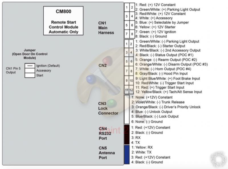

You should just be able to connect your CM800 grn/white (-) parking light to the Blue (-) parking light in that green connector.
Check with a meter first though to make sure its right.

I mean Grn/wht in CN2 harness. Connect negative to negative.

As mscguy says.  The CS800-s has two Parking Light Outputs.  Both are GREEN / WHITE wires.  The (+) Parking Light wire is in the CN1 connector and is a thick wire.  The (-) Parking Light wire is in the CN2 connector and is thin.  You should be able to just directly make than connection, CN2/1 GREEN / WHITE to the CRV's Green factory alarm plug, Blue wire at Pin 9, no relay required.  The CN1/2 GREEN / WHITE (+) Parking Light output wire should be disconnected / not used.
