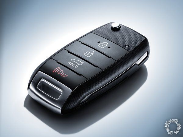

What is pts? How about the chip that is in the key fob. Don't use need a bypass module to remote start? This is the key fob I have.2015 kia sorento remote start -- posted image.

PTS = Push To Start. That key looks like a normal key that flips out. If it is a flip out key then yea no bypass needed, just the Viper 5704v. If you actually have a PTS then you would need a bypass module like a DBALL2
