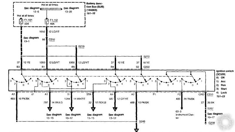

Posted: February 11, 2016 at 8:56 PM / IP Logged Link to Post Post Reply Quote jcharley
I'm looking at the link posted for the wiring info and it does not show a 2nd ignition. However bulldog security does.    The bulldog site shows the 2nd ignition as the same as 1 of the 2 1st accessory writes on the ready remote site. Is there any way to confirm which is accurate. If it does in fact have a 2nd ignition I will need to use the 2nd ignition wire to start the vehicle and will need to use a different wire for the 2nd accessory. I have a few negative pulse wires that can be programmed to same as ACCY (I'm assuming means accessory). To do this I would need a relay covering to a positive output I'm guessing. IS this correct and can anyone confirm if which site is correct on the 2nd ignition.
http://www.bulldogsecurity.com/bdnew/vehiclewiringdiagrams.aspx
http://readyremote.com/main.asp?action=select&yr=5606&product=Remote%20Start&make=Lincoln&model=Town%20Car#
mscguy
Copper - Posts: 212
Joined: November 28, 2015
Posted: February 11, 2016 at 10:08 PM / IP Logged Link to Post Post Reply Quote mscguy
Discrepancies in wiring diagrams? Time to break out the multimeter.
This is your ignition switch.
I would lean towards bulldog on this, but you can test yourself.
You can use one of those programmable outs to drive a relay for the 2nd Acc wire. Obviously not one of the ones you're using for the arm and disarm.
