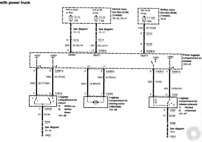

Bulldog says red, but the diagram pdf says purple / YELLOW from trunk pop switch. Check with your meter and see.

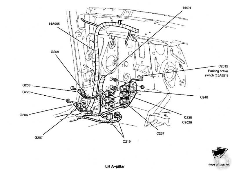

You can try in the drivers kick, should be a red one. You won't find a connector, you'll have to dig in that "14A005" Harness.

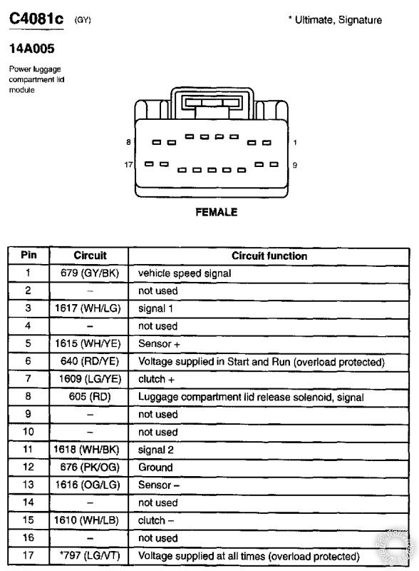

Also, in the trunk on the left side, is the Power luggage module. Red wire there too, Grey 17 pin, Pin 8.
Now, this wire is a (+) signal though, so you'll have to use a relay to change it. I'm assuming your start's is a negative. I didn't check.
Use your meter to check. Red probe to suspect wire, black probe to ground. Correct wire will show +12V when trunk release button is pressed.

So I don't need to do the 5 wire as shown on bulldogs site. Also I found a red wire that blips a positive when i push the trunk release but does nothing when I press it to close
mscguy
Copper - Posts: 212
Joined: November 28, 2015
Posted: February 26, 2016 at 7:29 PM / IP Logged Link to Post Post Reply Quote mscguy
Since that RED wire is going into a module, it's probably resting at ground. Do a 5 wire.
Where are you testing the wire at? How long is the "Blip"? 1 second? .5 second? It doesn't take long to trigger a solenoid, so even though you hold the button down, the module probably only outputs for less than a second.
