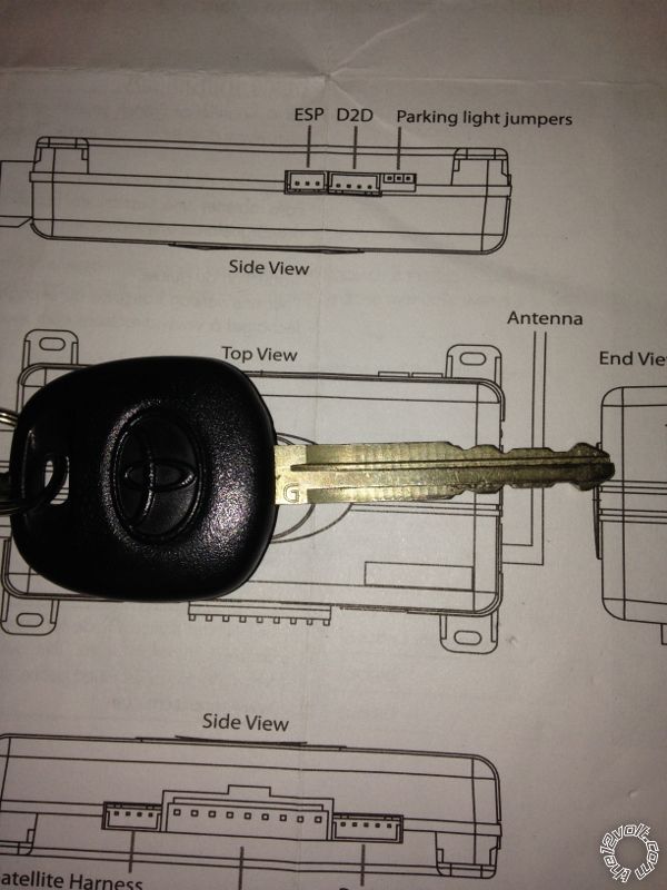

Are you 100% sure it's a g key. Look at the key switch. Is it a plain metal switch? Does it have BLACK/ clear plastic around it? Disconnect the dball2 and try to remote start it.

I have a blinking security light, and the Key says G on it. The connections are T-taped. I even took the tap off and put the 2 HS can and SIL wires and stuck them into the OBD II connector holes. If I put the key in the ignition (not turned) and push the remote start button, the truck starts up and idles. Xpresskit DBALL2 Error -- posted image.
