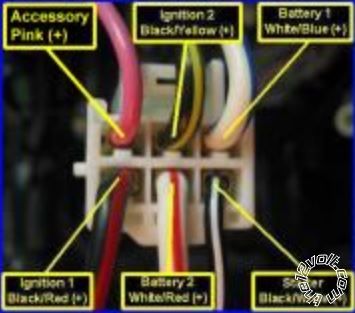

Here is a photo of the trucks ignition switch connector with the wires marked ( from ReadyRemote ).
Viper 5601 to 2004 Toyota Tundra -- posted image.
Are all of your connections soldered?
If the engine cranks but does not start and run, it could be a wiring problem or perhaps your truck is one of the few that
has a transponder based immobilizer system.
If the engine starts but shuts down within 5 seconds it could be a Tach issue.
If it doesn't crank at all but the instrument cluster lights up it could be a wiring issue.
It could be that the Vipers Neutral Safety wire is not grounded.
It could be the Vipers NSS is not plugged in and turned to ON.
It could be the Hood Pin wire grounded.
It could be that the Brake Input has +12V on it all the time.
If it does nothing but flashes the Parking Lights it could be Viper programming...
I could go on but...  Perhaps you could list all of your connections as Mr. Smoke requested in Post #2 and supply some
additional info as to the exact symptoms when you try a remote start.
