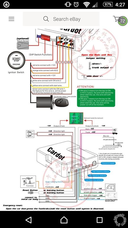

I have Honda Accord 2009 Coupe EX-L. I have a Issue About the Remote Start on my Cardot 1100an Alarm Remote Start (China Brand). The Alarm System Dont have the Factory Rearm/Disarm and Ground-While-Armed. Every time I press remote Start the Factory Alarm on/triggered. and I used DEI 556U Universal Immobilizer Bypass.
Any chance to add or create a Factory Rearm/Disarm? for the Alarm System?
This is the Diagram of Cardot 1100an
09 Accord, How to Create a Factory Rearm/Disarm? -- posted image.

The 2009 Accord factory alarm arms and disarms with lock and unlock.

Im looking for add-on for Alarm System
The Alarm system dont had the Factory rearm and disarm output.

No add-on needed. When you use your door lock/unlock outputs from your Cardot unit to lock/unlock the doors, the factory alarm will arm/disarm.

If I remote started, the alarm goes on/triggered. How I can disarm factory?

If you don't want to unlock the vehicle before you remote start the vehicle, you can try using two relays on the ignition output of your remote start. One to supply 12V+ to the vehicle's ignition wire and the other to provide ground to the vehicle's key sense wire. However, if it still triggers the factory alarm when you remote start the vehicle, then you can try supplying ground to the key sense wire from the "ground while armed" output you have from the relay setup I created for you in your other thread.
KEY SENSE      Pink      Ignition switch harness in white plug       -

Posted: March 21, 2016 at 9:40 PM / IP Logged Link to Post Post Reply Quote kulblue
WORKS GREAT!!!! Thanks again @the12volt
Key Sense   white    ignition switch harness   BTW. Anyway Thanks!

One reference I have shows pink, hence always using a meter to verify any wiring information before making any connections.
