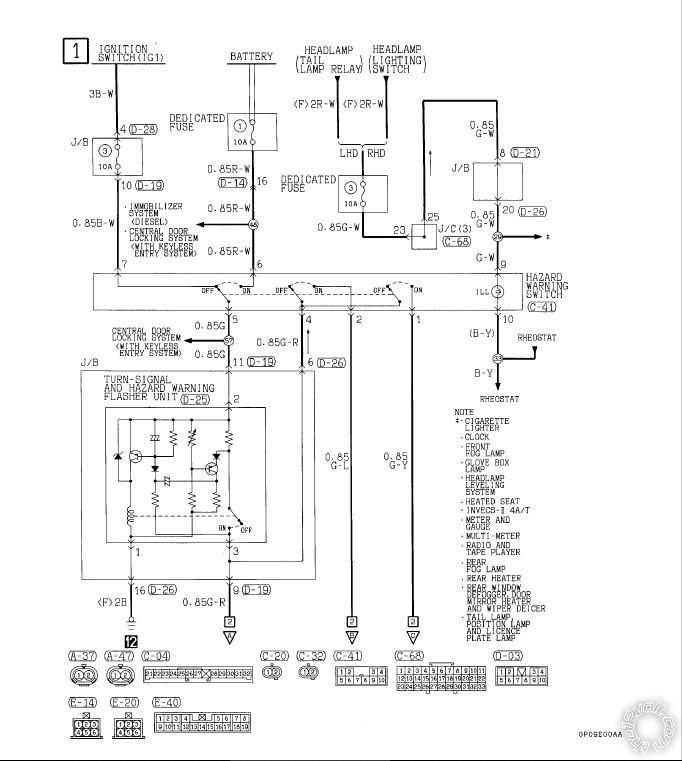

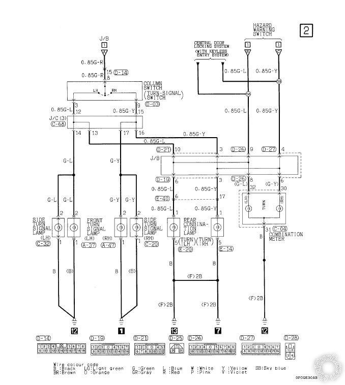

This is the wiring diagram for the Hazard and turn signal
New member, new keyless and first -- posted image.

Looks like you would need to connect after the hazard switch in diagram 1. Using 5 amp diodes band towards the vehicle wiring to connections 1 and 2 with (+) 12v or use 2 relays to power each circuit separate. The left and right are only combined when the hazard switch is on. So you will need to power them both.

Not Norway, everywhere but North America uses amber direction indicators Lurch is correct.
As for the rest, find the GREEN/ blue and GREEN/ YELLOW in the steering column loom wire the Code as POSITIVE switching parking lights and split the white output via 2 X 1N5404 diodes, bands away from Code.
