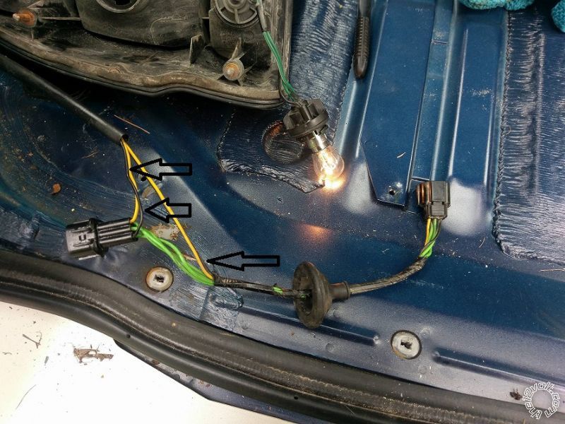

Then the problem is fixed. That little wiring harness in the picture was to blame. It is a aftermarket splitter for the trailer connector.
The black wire that I have highlighted with arrows in the picture splits the G-W wire, runs down to the trailer connector and back to the rear combination lamp. This wire was broken inside the trailer connector.
