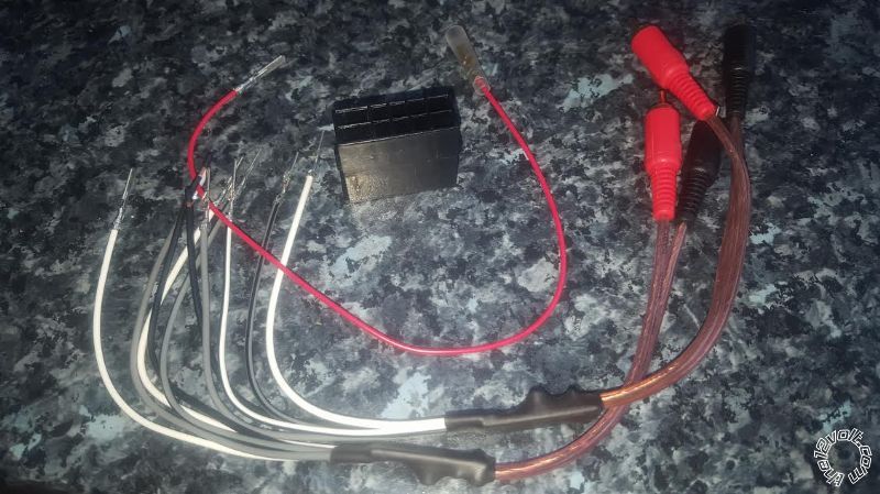

Ok thanks for the advice, i brought a new bit of wiring and was hoping that it was per wired but its not, this is now what i have, any ideas of what wires go in to which hole

Platinum - Posts: 13,720
Posted: August 24, 2016 at 2:37 PM / IP Logged Link to Post Post Reply Quote i am an idiot
Stab the pins exactly like your other harness. Put the white where the white is on the other one. Put WHITE/ black where the WHITE/ black is on the other one, and so on.

Posted: August 24, 2016 at 2:54 PM / IP Logged Link to Post Post Reply Quote red baron
ok, but they all seem to be black in a photo i have (on the car side)and surely they have to be paired??
or am i just being stupid........
Posted: August 24, 2016 at 9:28 PM / IP Logged Link to Post Post Reply Quote i am an idiot
I will look at work tomorrow and see if I have the Metra harness. If I do, I will take a pic of it.
