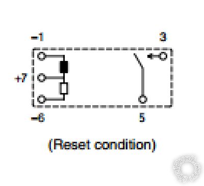

Using the (-) unlock output from alarm to Pin 1, (-) lock to Pin 6, (+)12v constant to Pin 7, Pin 5 to Ground and Pin 3 to (-) output. This relay uses no power to maintain connection.
How to Create a Ground While armed? -- posted image.
Dual Coil Latching Relay Part #ADW1212TW

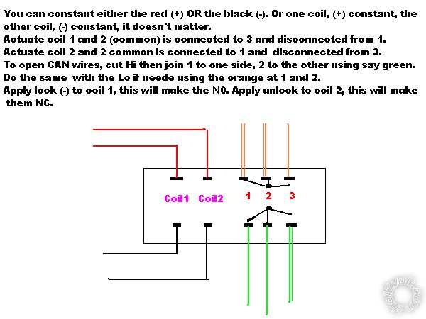

Posted: September 04, 2016 at 12:58 AM / IP Logged Link to Post Post Reply Quote howie ll
Here's one he can buy in Europe old diagram for a different purpose, an old Clifford Solaris from the mid 90's with only one aux so I had trunk release on disarm and headlights when armed. Use lock and unlock outputs branch off alarm's lock unlock with diode separation. 9A9_latch.bmp
RS Components or Farnell.
Posted: September 04, 2016 at 1:08 AM / IP Logged Link to Post Post Reply Quote howie ll
Here's the part number:- G6CK-1114P-US

Posted: September 04, 2016 at 1:49 AM / IP Logged Link to Post Post Reply Quote lurch228
@howie II you part number is a 5v coil, It should still work but wouldn't a 12v coil Omron G6CK-2114P-US or a G6CK-1117P-US-DC12 be a better choice?
Posted: September 04, 2016 at 4:26 AM / IP Logged Link to Post Post Reply Quote howie ll
It's 12, I'm looking at the etched details on one right now!
Meanwhile AFAIK all the above are applicable.
1114P = SPCO
2114P = DPCO
lurch228
Silver - Posts: 1,338
Joined: August 08, 2012
Posted: September 04, 2016 at 4:33 AM / IP Logged Link to Post Post Reply Quote lurch228
The most popular google results come up for the 5v coil.
Unless you add the -dc12 to the end of you part number. Then the 12v coil shows up.
