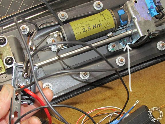

I finally found where the attachment link was. Not too much to see except you get to see the spoiler's set-up. As I said, red + (from 12V battery) is on A; black wires from continuity with D to + motor contact; black wires from continuity E to – motor contact.
Note: white arrow points to basic down limit switch.

Posted: November 09, 2016 at 5:34 PM / IP Logged Link to Post Post Reply Quote alfa/resto
I'm sure the geared window motors are also quite stiff (for wont of a better term). I'm getting the motor to partially turn, but almost immediately it blows the fuse. Last one was a 30 amp. This was another reason I want/need to use a relay unless you have a better idea.
I somewhat screwed up the motor - though feel I can fix it - but have ordered another one on eBay.
