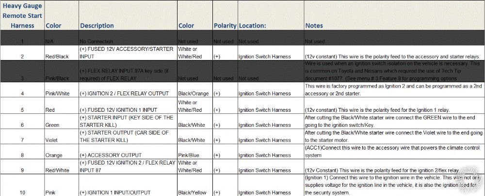

I'm sorry the RED / white. I also have it hooked up to ign 2.
smokeman1 wrote:
The pink/white IS NOT suppose to be connected to a 12volt constant source. It is a output to your ignition 2 wire.

Your choice. The RED / White belongs to a 12volt constant, not an ignition wire

Alright this is the new version. Everything okay now?
Toyota Supra Remote Start Viper 5706v - Page 3 -- posted image.
