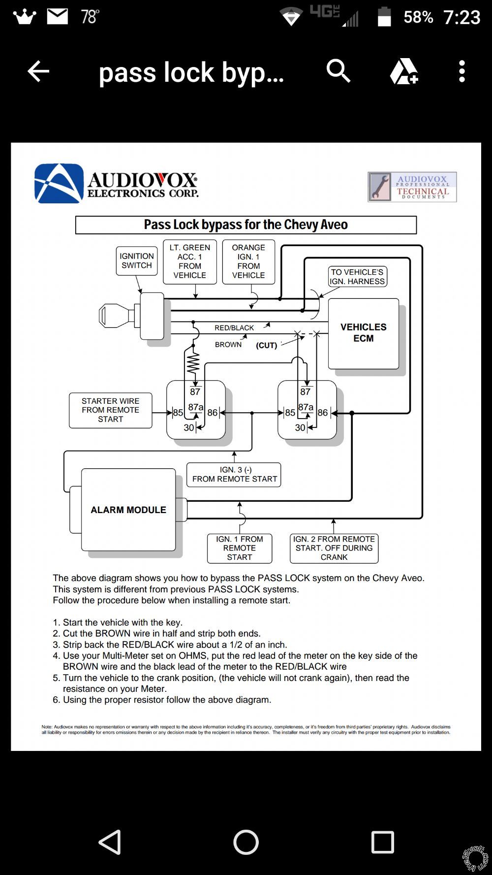

Ok really getting frustrated here. Have an 09 Chevy Aveo and have some tons of research before starting this and decided to tackle it.... Not going to easy. Have a viper 4105 remote start. Have done the bypass pictured here.
I additionally have 12v running to both the 30a input wires. I also have the ground wire and neutral safety switch input wire grounded to the chassis. I have tried everything and for the life of me can't get the led to blink, come on, flash or anything. I realize none of the outputs are hooked up but no point in hooking them up if you can't even get power to the box.... Any ideas? Here is a link to the install guide as well. Thanks in advance! Dale

Viper 4105 2009 Chevy Aveo -- posted image.

Sorry my bad not purple they are red was totally going off memory when wrote that. Here is the 4105 wiring diagram... Not sure how that crosses up the the h2 thing you sent me but the way I understand what your saying is if I have constant 12v going to the 2 red wires (#s 4 and 6 in the diagram) the pink wire (#1) going to an ignition source , the #8 on the 9 pin harness grounded to the chassis I should at a minimum be getting some action from the led is this correct?
