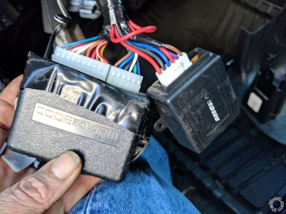

So here is the current keyless entry system. Not sure what the second smaller box is. 2013 Nissan Versa with no immobilizer -- posted image.

Posted: November 10, 2017 at 6:23 PM / IP Logged Link to Post Post Reply Quote rraider1
Ok, guess the smaller box is the relays that come with the aftermarket actuators. Tomorrow I'll undo all the tape and hopefully I can figure out how its all wired from there.

Posted: November 10, 2017 at 6:47 PM / IP Logged Link to Post Post Reply Quote kreg357
Here is a link to the CA-2051 unit :
http://www.voxxelectronics.com/docs/common/CA2051/CA2051_IM.pdf
