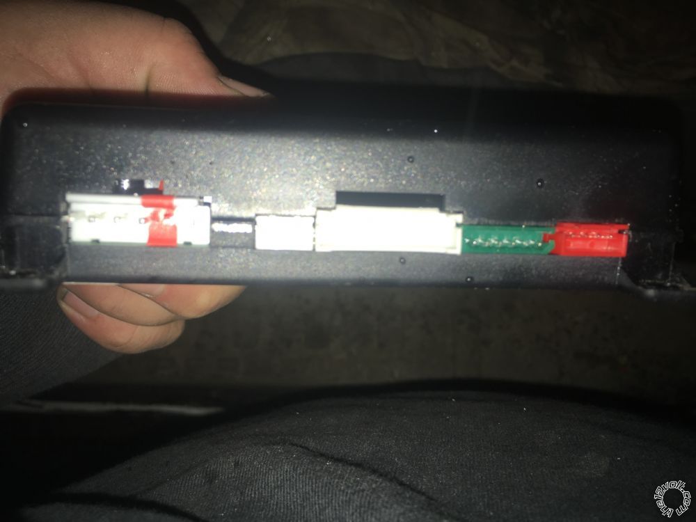

Do you see the black unused 2 pin port on the same side as most of your other harnesses? Try something like this:
https://frys.com/product/1350536?site=sr:SEARCH:MAIN_RSLT_PG

Posted: November 12, 2017 at 6:58 PM / IP Logged Link to Post Post Reply Quote munsie
viper 4916v remote start -- posted image.
It’s not there that I see

Posted: November 13, 2017 at 6:07 AM / IP Logged Link to Post Post Reply Quote geepherder
Okay. I'd double check the number of flashes, then. The manual has nothing listed for 10 flashes.
